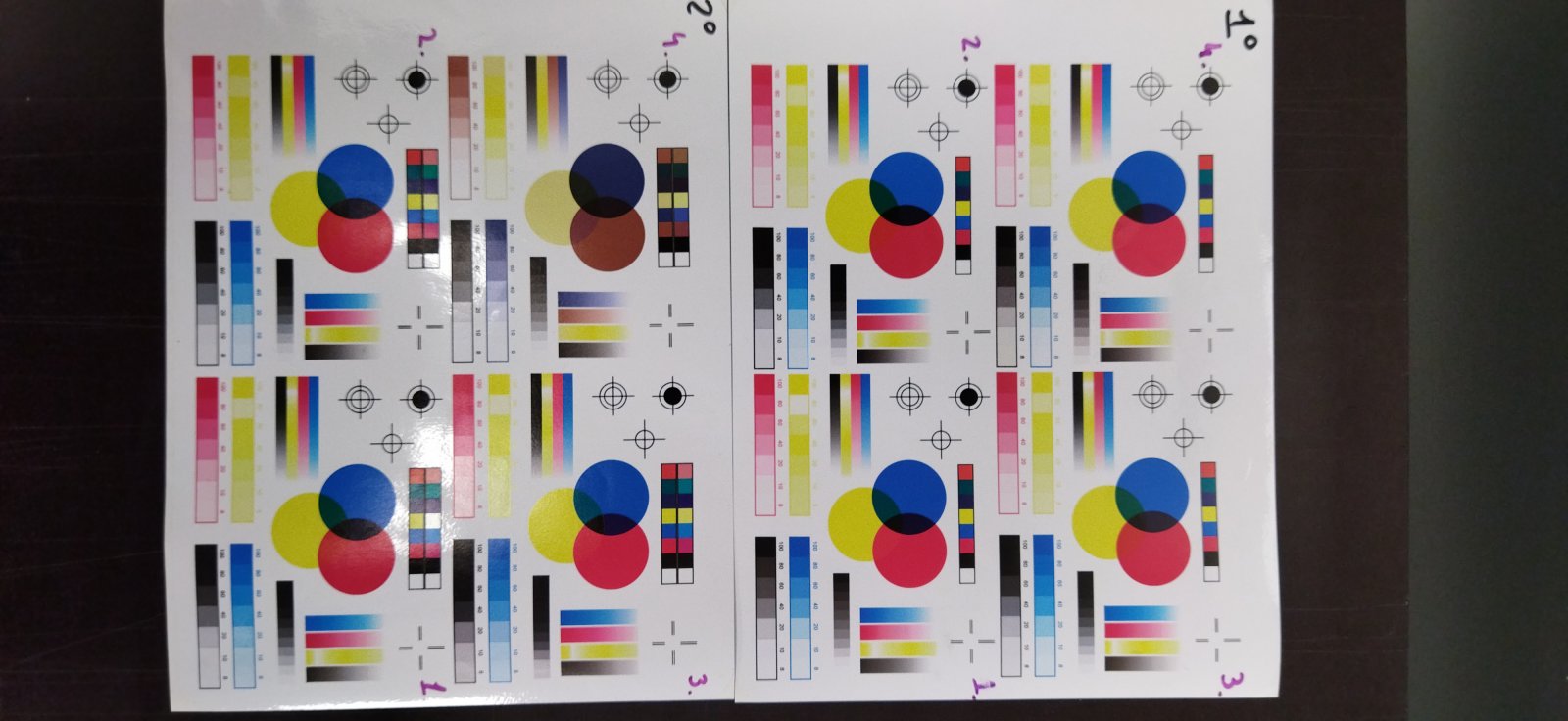

    Check 80% Y faillure
    Head Gap Large on printing options fixes the problem.
    We think this could be a firmware Bug,
    But since the variable dot off fixes the problem we may need buy a new printing head.
    What do you guys think about this?
