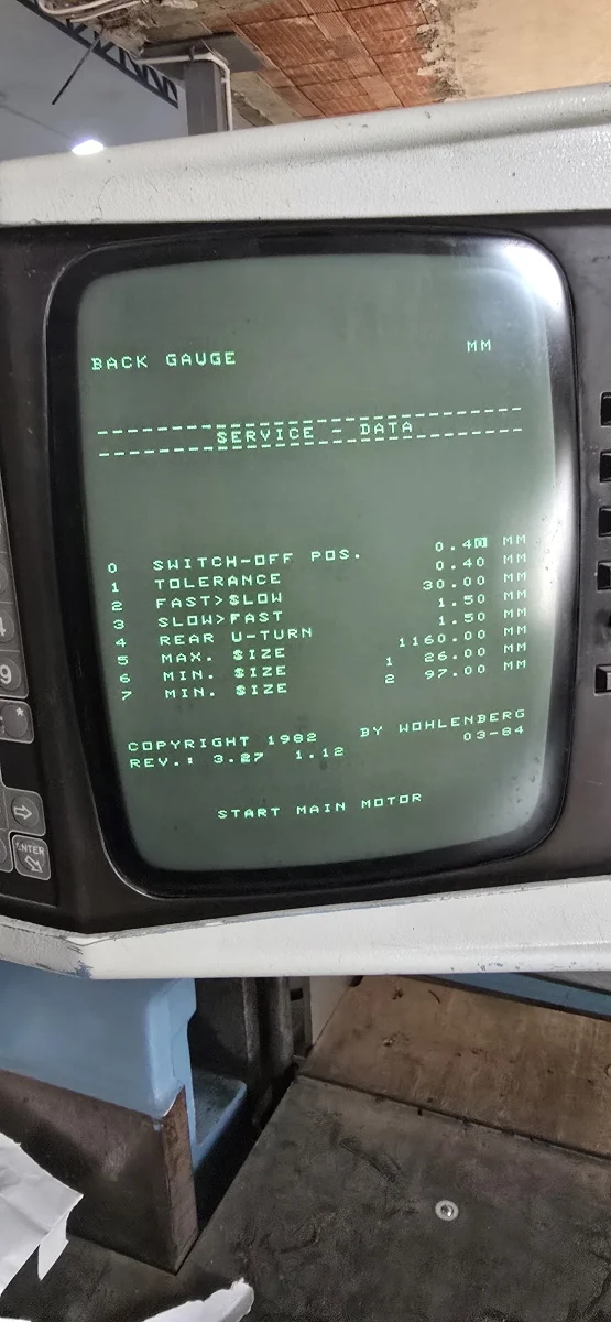

Hello everyone, I have a problem with Wohlenberg MCS-2TV
Machine number: 3376-027, after I replaced the dead battery, I had to insert the parameters, I found some parameters on the forum, I'm not sure that the correct parameters were inserted and now I can insert the program but the machine will not switch to automatic mode, the screen tells me to switch to automatic mode but when I do that nothing happens. I'm interested in your opinion, is it possible that the switch is faulty, bad parameters or something else?

    Dear sir, I haven't been able to do anything, I took a picture of the parameters I entered, can you tell me if they are OK for my model 92? Thanks in advance.
    Hello, can someone help me?
    I entered the parameters from the picture on the Wohlenberg MCS-2 TV 92 but I can't switch to automatic mode.
    Can someone tell me if the parameters are correct?
