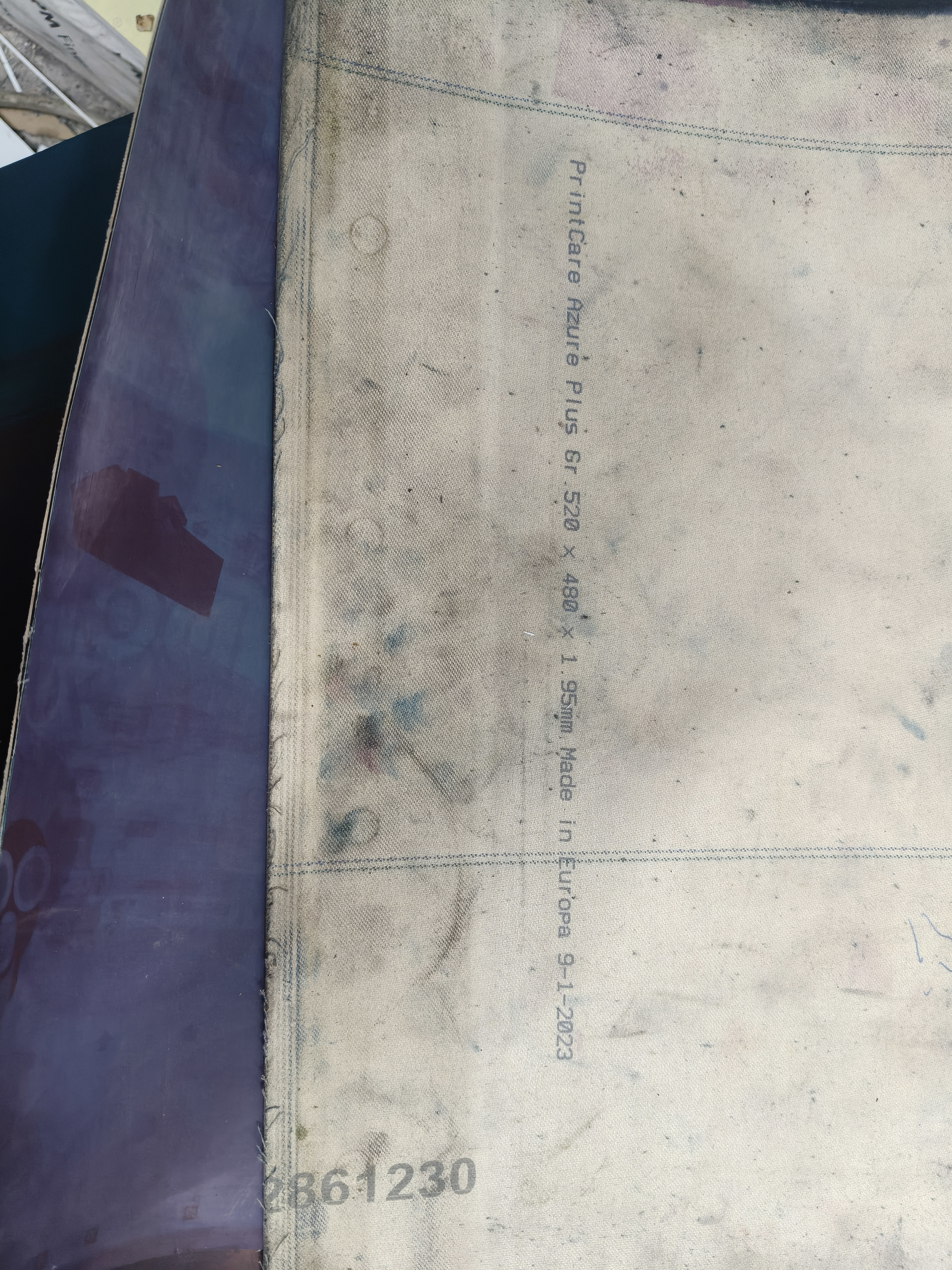

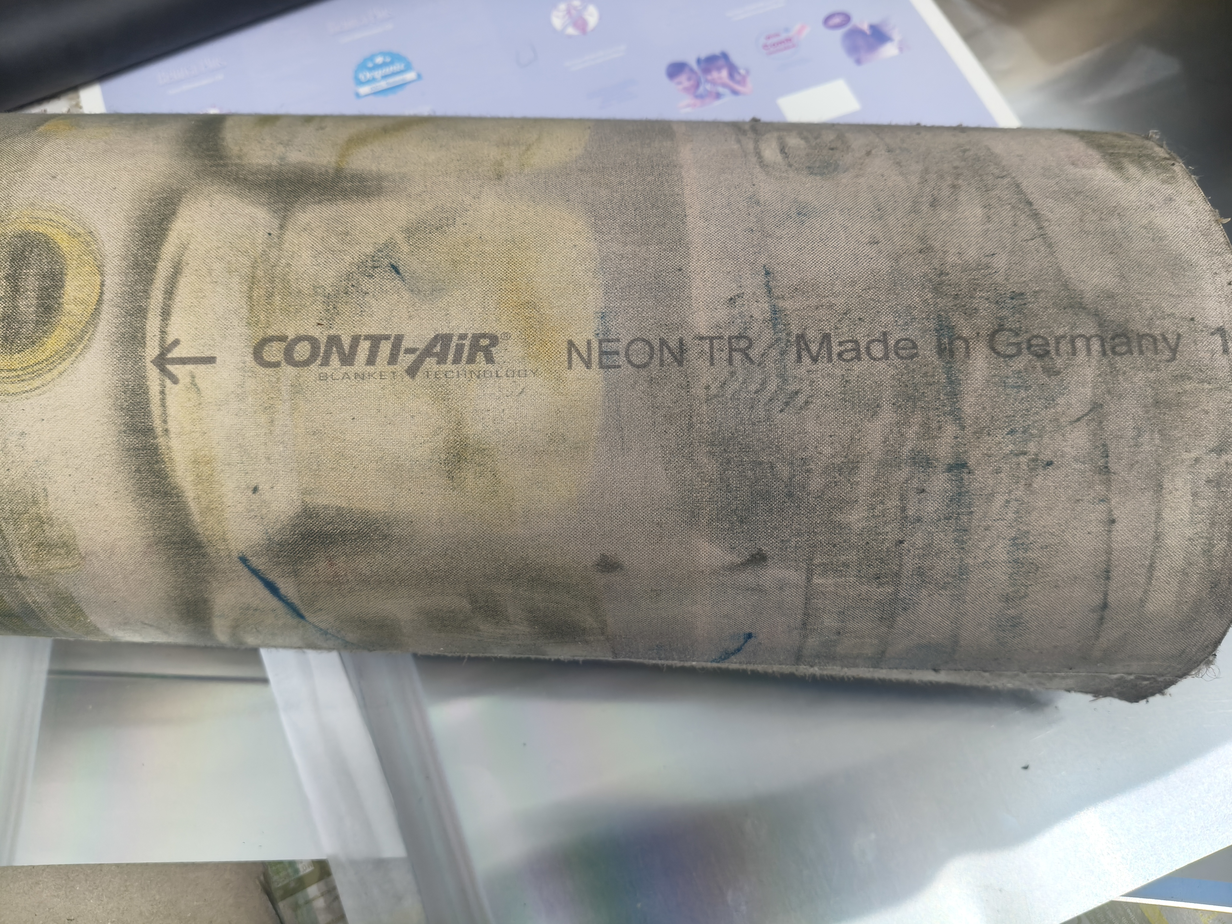

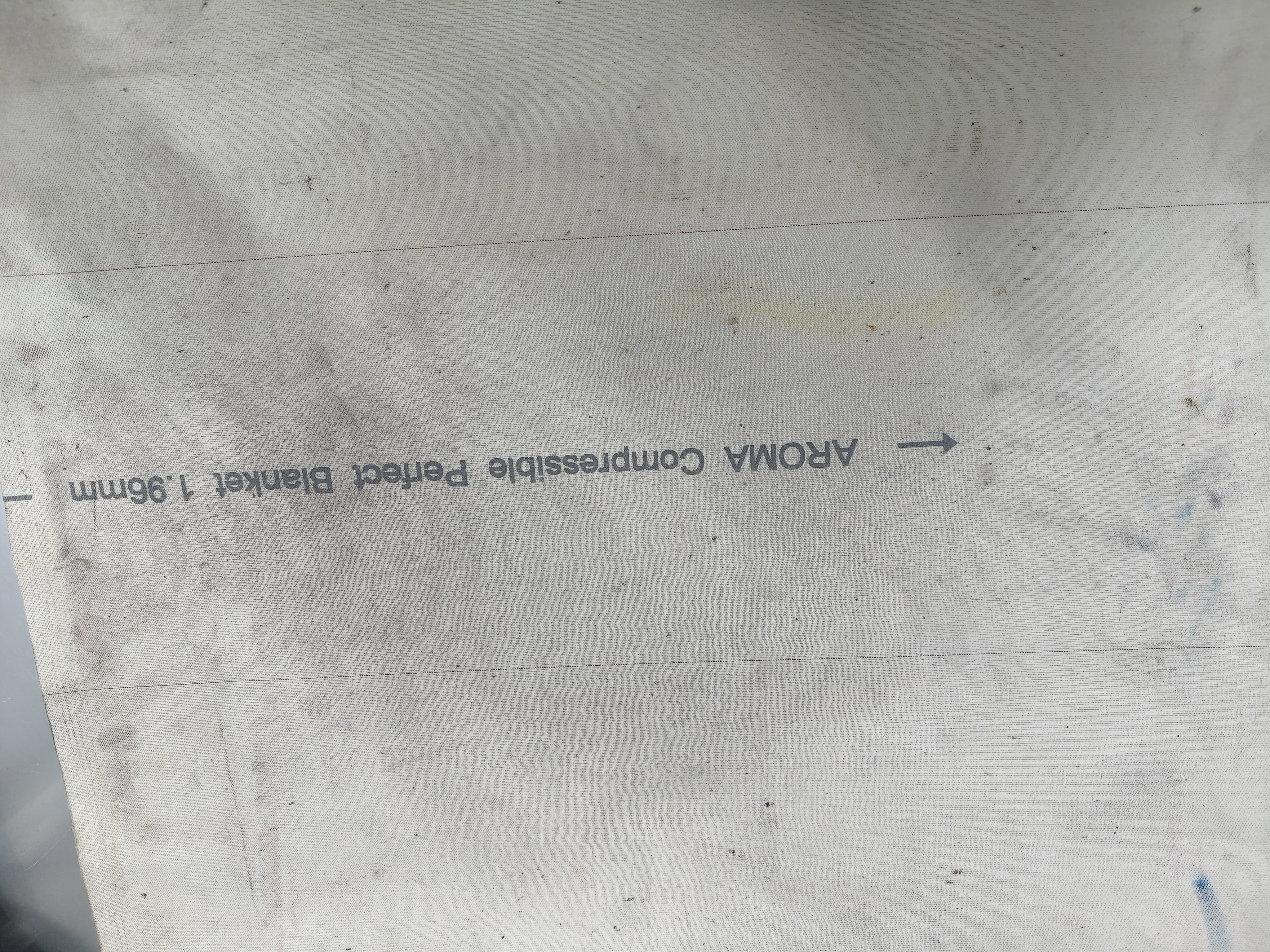

I use a GTO52 DDS printer and I'm having trouble with excessive lines appearing in printouts when using high-color ink cartridges. I've tried different types of printing blankets, but the problem sometimes persists. I don't know which type of printing blanket produces fewer lines, even though I've replaced the printer's ink and water rollers. Are there any specific reasons for this problem? And which of these three types of blankets is the best?

  • Wow, the back of those blankets are filthy!
    Makes me wonder about care & attention to other basic fundamentals.
